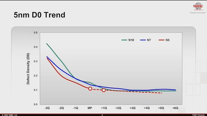

Anyways for the D0 part is 0.4 good i found a slide from tsmc N7/N5 while searching online considering 18A was going to be HVM ready in 2H24
I think this other slide from the Aug 2020 TSMC tech symposium is more helpful.
Assuming Panther lake mobile SOCs launch in September like prior gen ICL/TGL/LNL SOCs, then 18A would currently be -4Q from MP (sept in this graph). Assuming the -4Q DD trend from TSMC follows the same slope it was on in Q3, then 18A measures up similarly to N5 at that point, a bit worse than N7 and alot better than 10FF.
tsmc's N2 HVM is projected for Q4 2025. Assuming that both tsmc and Intel experience similar yield trend improvements, the D0 trend for tsmc's N2 and Intel's 18A could align on a similar timeline.

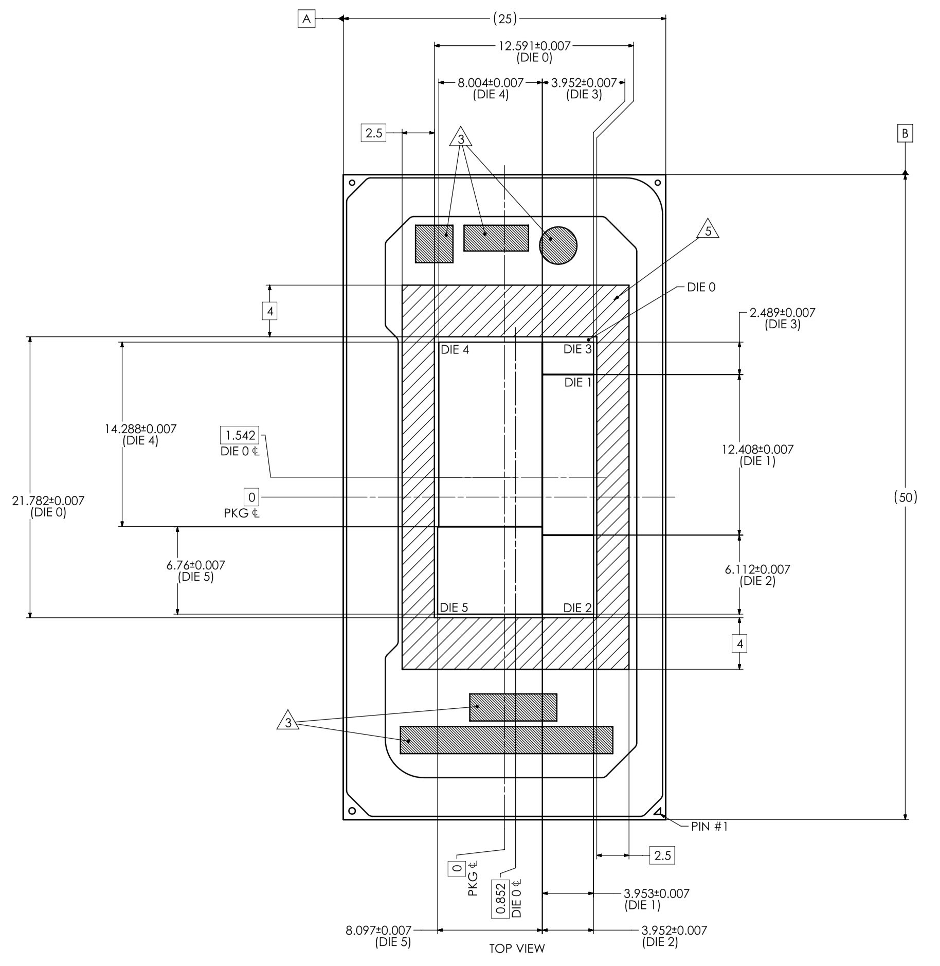

The Panther Lake die size is reportedly larger than Raptor Lake: https://wccftech.com/intel-panther-lake-cpu-configurations-up-to-16-cpu-cores-12-xe3-celestial-igpu-cores/#:~:text=Die 1 (Platform Tile) -,6.112 x 3.592 = 24.154mm
The five parts are supposedly all Intel 18A the way Intel describes Panther Lake as representing 18A success: https://www.intel.com/content/www/u...ckley-talks-progress-intel-18a.html#gs.dvxonf. So it makes sense to consider them all together.

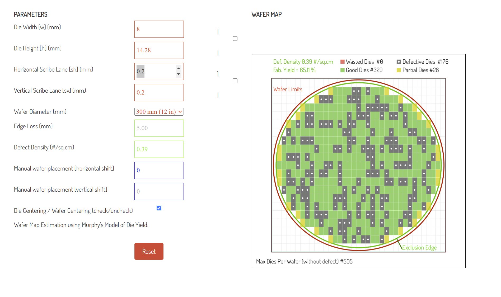

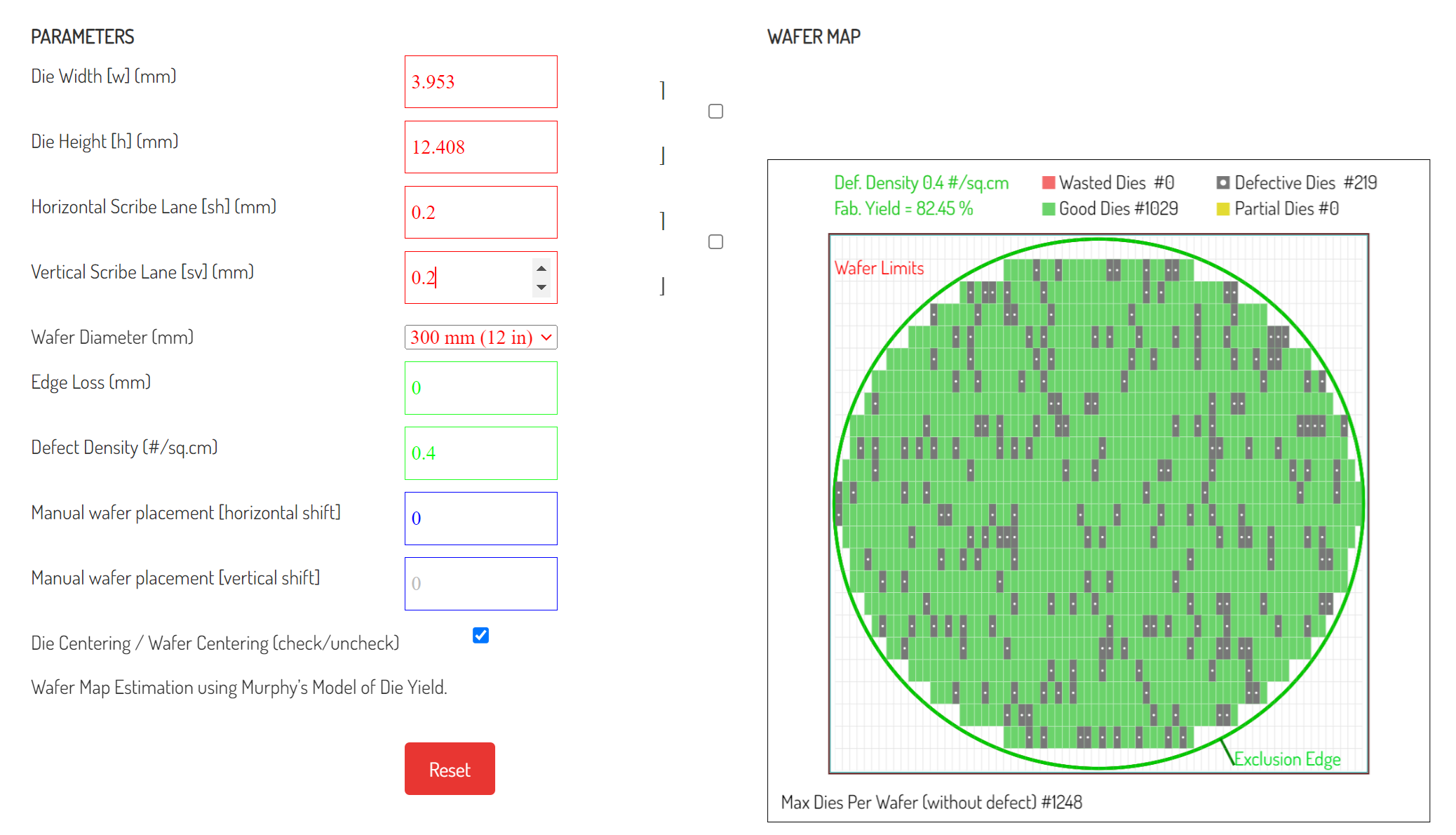

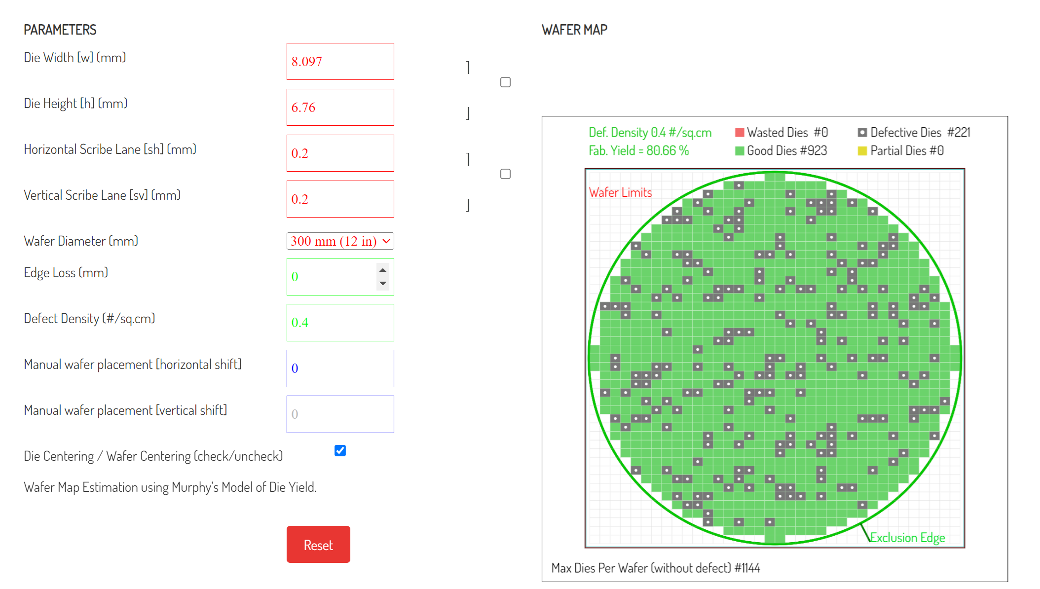

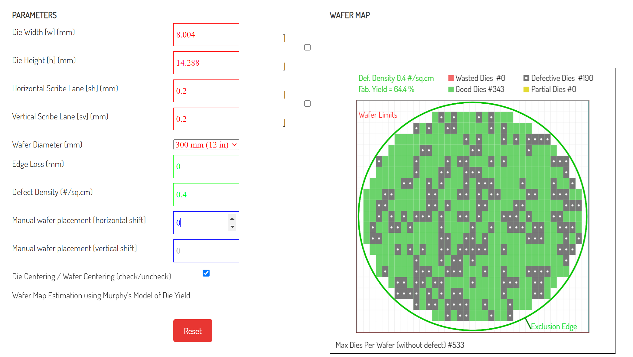

I found two of the tiles were passive. If we just use the three active tiles, we get 64.4%, 80.66%, 82.45%
I found two of the tiles were passive. If we just use the three active tiles, we get 64.4% x 80.66% x 82.45% = 42.8%.
Should we multiply them to get the yield? I was thinking in terms of usable area of a wafer. It is above 60%. By matching the quantities of each tile, should the final yield also be above 60%?

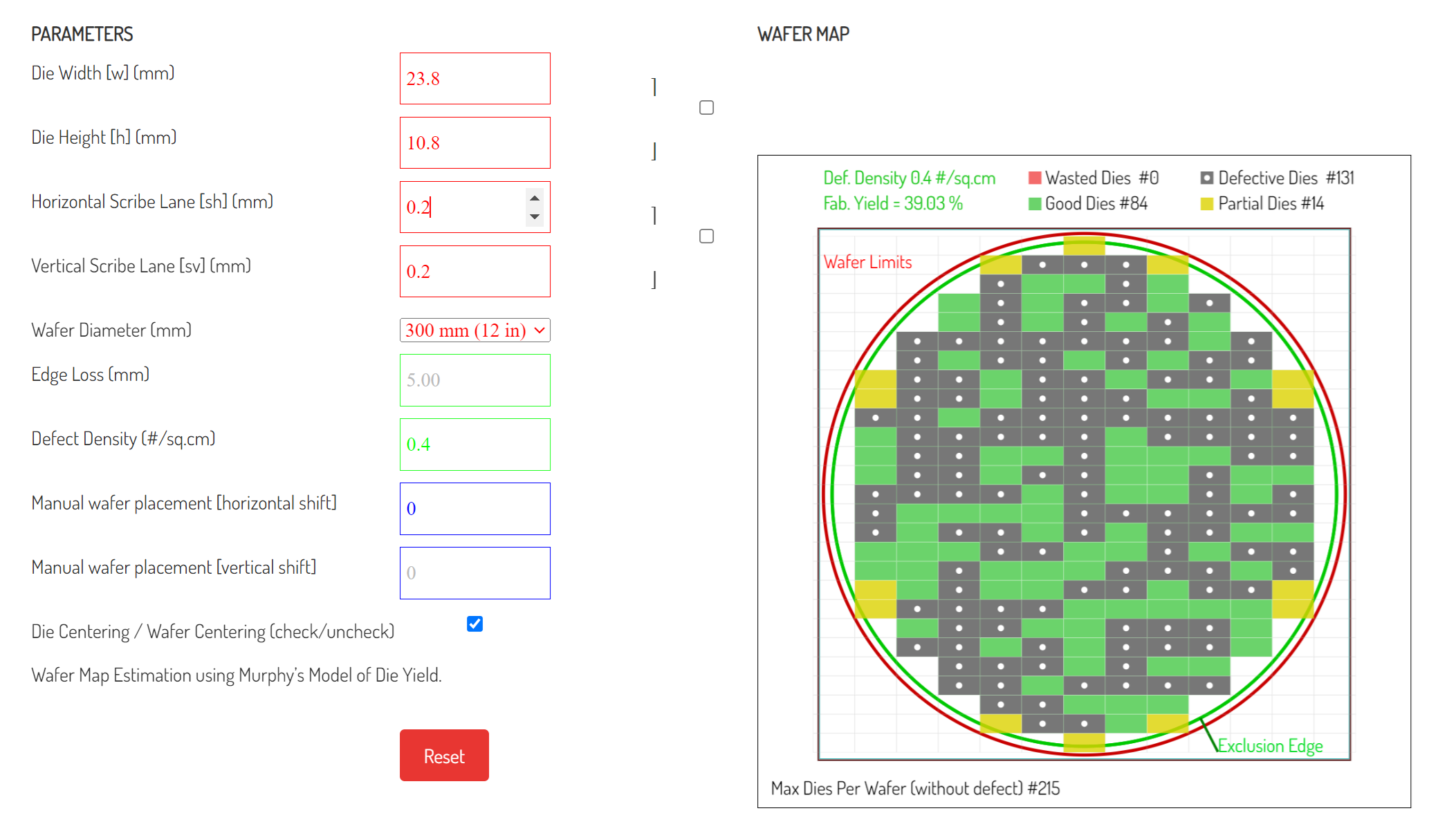

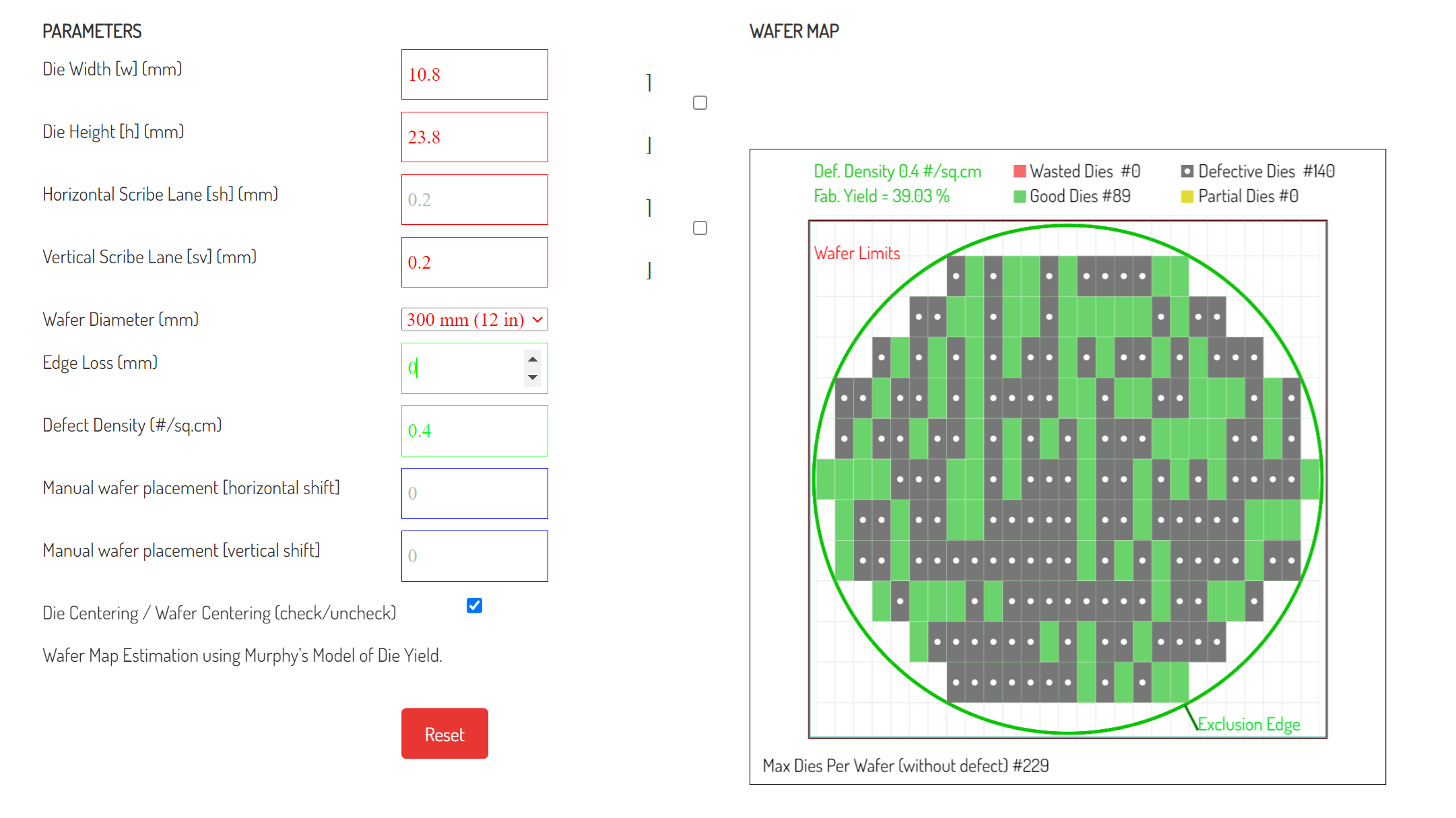

D0=0.4/cm2 is not good for yield at all for a chip sized like Raptor Lake.
View attachment 2222View attachment 2223
You are not wrong, but I would be shocked if in one year from now the DD was still 0.4. The real question mark is what is the DD slope going to look like over the next year? It's all well and good if DD is similar to N5 at a similar time, but if the slope looks more like N7's slope than N5's we are talking like 0.18DD (64% for RPL using the same website) instead of 0.12DD (74% for RPL).

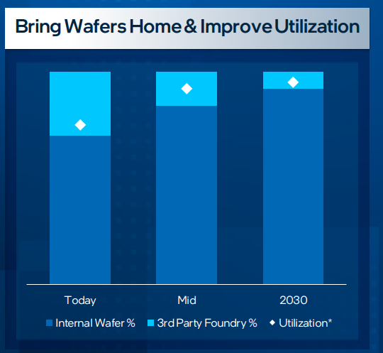

Why would you assume that multiple different partition dies are all 18A? Intel has used the statement that Pantherlake starts shifting the die area back to intel, but intel doesn't indicate they are going back to a more "normal" external foundry usage until that 2027-ish timeframe where we will likely be talking about PNL-next-next and 14A. Also 18A isn't intel's only process technology either.

Why would yield be multiplied like that if intel has KGD singulation pre packaging?
You're right, I was thinking about it just afterwards. I think we should just consider the separate tile yields as if they were the chip die yields.
Ideally 562,848 of each tile would just use up 451, 492, or 1056 wafers for the platform, graphics, compute cases. But due to the compute lower yield, it is now only 362,208 of each tile. So it would be 64.4%.

Since Panther Lake is used for touting Intel 18A success, I had made this assumption. If it were just the compute tile, I would have expected them to be specific about that, as they were for Meteor Lake.

PTL-H 18A chiplet has a die size of nearly half according to rumours Clearwater forest 12 18A chiplets of E core which should be even smaller
Correct PTL-H is 18A chiplet with 4P+8E+4LPE with NPU and memory controller and display logic GPU is N3E and N6 IO tile in the diagram Die 4 is 18A and Die 5 is N3 GPU
PTL-U Is 4P+4LPE with NPU/display logic and memory controller Intel 3 GPU tile and N6 IO a cheaper lunar lake from Intel Lunar lake
The source for the info

Yield for die/tile is usually a fab yield indicator related only to fab and a combination of Fab line yield loss, WAC and Functional Test. Good tiles are assembled in the tile concept would be CoWoS and that yield is generally very high for mature, I can guess for the latest lCoWoS they aren’t nearly in the high 90s but better not be 60% as that would be atrociously expensive as you are throwing away multiple very expensive die at the last step, but it ain’t high 90s% as in the mature simple OSAT process
