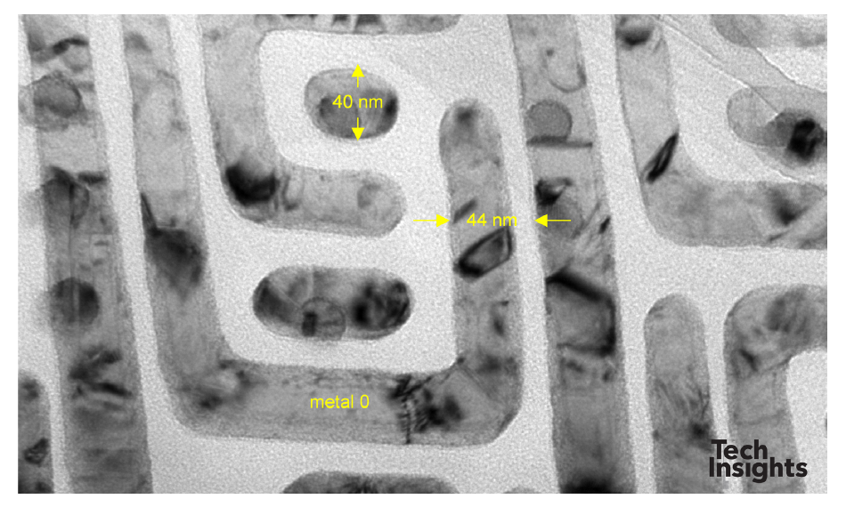

But if pictures are available in the future, and the layouts look more like Samsung style, I would call it Samsung 5nm-class. Tests showed it could be compared to the 888 (5LPP).
To clarify what I said earlier, I refer to Figure 4 available from here: https://www.techinsights.com/blog/e...er-technological-independence-and-advancement
It's from a Samsung 5LPE layout, but the design rules are in line with TSMC N7.

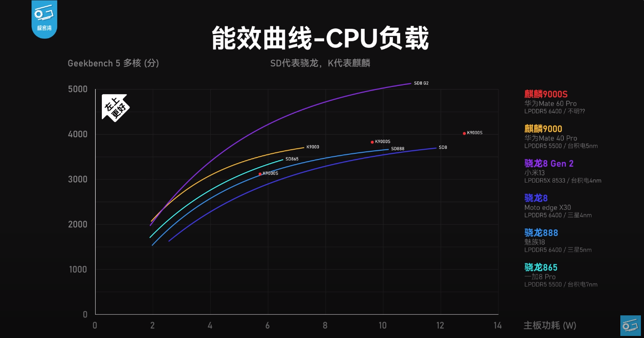

Not sure if they showed anything different from Geekbench: https://www.gizchina.com/2023/08/29/huawei-mate-60-pro-processor/
Not just Geekbench scores. They do massive performance/energy testing on Kirin 9000S' individual big/medium/little core and compare to SOC by tsmc/Samsung.
In conclusion, the performance/energy curve of SMIC's N+2 is better than Samsung's 5nm (Snapdragon 888) but worse than tsmc's N7 (Snapdragon 865).
They haven't retracted their Youtube video but only Bilibili video.
Youtube video:

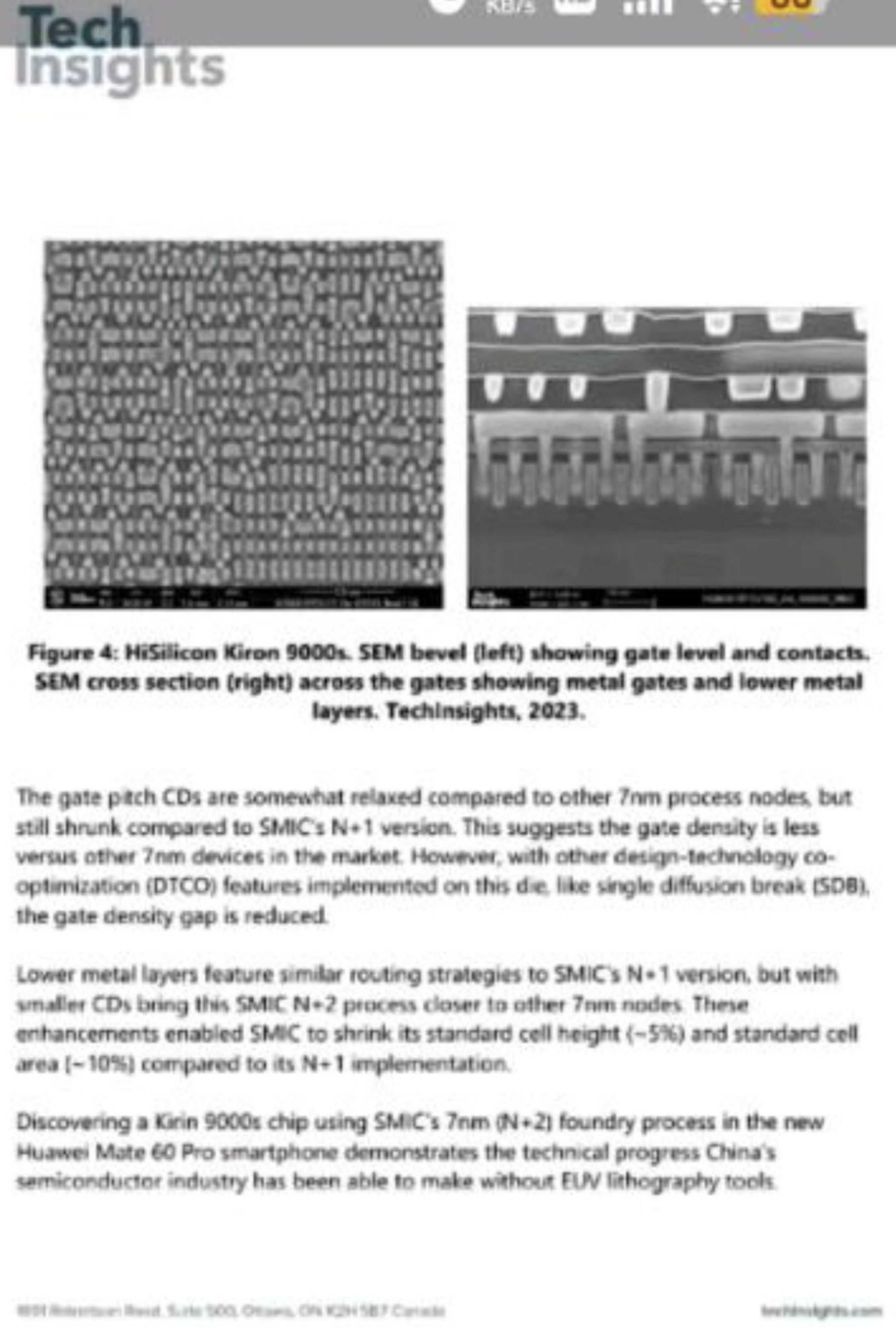

The gate patch CDs are somewhat relaxed compared to other 7nm process nodes, but still shrunk compared to SMICs N+1 version. This suggests the gate density is less versus other 7nm devices in the market. However, with other design-technology co-optimization (DTCO) features implemented on this die, like single diffusion break (SDB).the gate density gap is reduced.
Lower metal layers feature similar routing strategies to SMIC's N+1 version, but with smaller CDs bring this SMIC N+2 process closer to other 7nm nodes. These enhancerments enabled SMIC to shrink its standard cell height (-5%) and standard cell area (-10%) compared to its N+1 implementation.
Discovering a Kirin 9000s chip uting SMIC's 7nm (N+2) foundry process in the new Huawei Mate 60 Pro smartphone demonstrates the technical progress China's semiconductor industry has been able to make without EUV lithography tools.

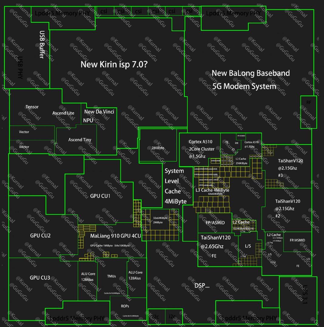

One interesting feature of this core,is that it has Hyper-Threading. Very unusual for mobile processor
It's discussed in the Geekerwan's video. TaiShan cores have hyperthreading because they were originally designed for server application. Considering the cost and delivery time, it's more convenient to modify TaiShan cores for mobile applications than develop totally new cores.
